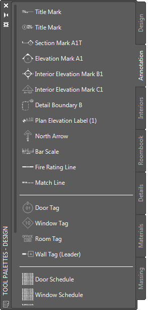

Tools provided with AutoCAD Architecture let you quickly place elevation labels using an elevation label tool with specific predefined properties. You can use the default settings of the tool, or you can change the properties.
Tool palette containing elevation label tools
The default tool palettes in the workspace contain sample elevation label tools that you can use and customize as needed. In addition, the following catalogs provided with the software contain elevation label tools that you can add to your tool palettes:
Custom palettes created by your CAD manager or other users may also contain elevation label tools with multi-view block definitions and properties that are customized for your projects or office standards.
