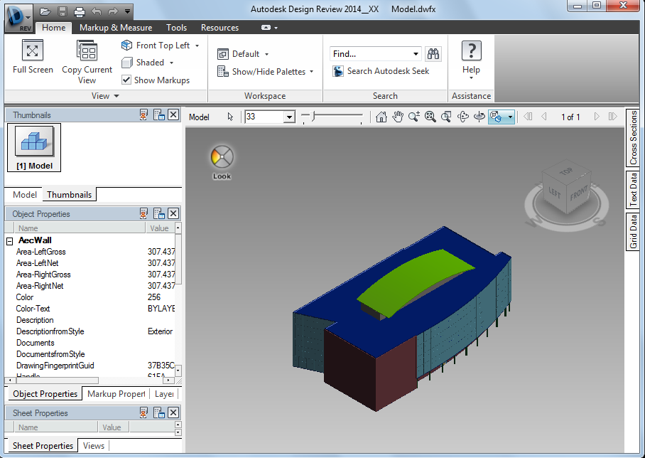

You can publish your DWG files as 2D or 3D model with the included property set data to DWF or DWFx. When these files are viewed with Autodesk Design Review, users can select components that represent objects and display the object information on the Object Properties palette.
Tip: To view published DWF or DWFx files, you need to install Autodesk Design Review. You can download the latest version of Autodesk Design Review from http://www.autodesk.com.
DWFx file published to Autodesk Design Review
