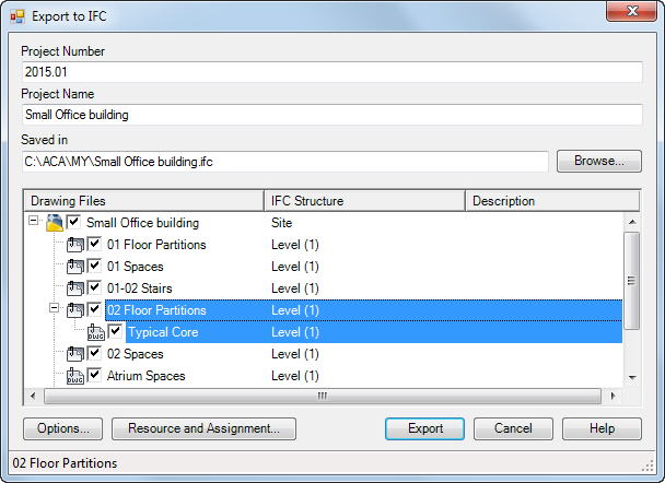

Use this procedure to export a project drawing as an IFC file. You can select the drawing from the Constructs, Views, or Sheets tab of Project Navigator.
Xrefs contained in the drawing being exported are listed in the tree view below the drawing name. If they were unloaded in the drawing, they are shaded in the Export to IFC dialog box.
If the drawings were assigned to levels as part of the AutoCAD Architecture project, a corresponding label is displayed by default under IFC Structure. Otherwise, they are mapped to Level 1 by default.
If there are objects you want to classify as a different type of object for export, the drawing with the classified objects must have been previously saved.
Export
IFC (Industry Foundation Classes). Alternatively, on the command line, enter ifcexport.
If you select an xref at the top level, all xrefs nested within this drawing are selected as well. Expand the top level, and select xrefs individually if necessary.
If you want xrefs to display as a distinct level within the IFC file, specify different identifying labels under IFC Structure. You can specify the same identifier, such as Level (1), for multiple xrefs to combine the objects within those xrefs into one IfcBuildingStorey.
You can select multiple drawing files and change all labels or descriptions at the same time.
