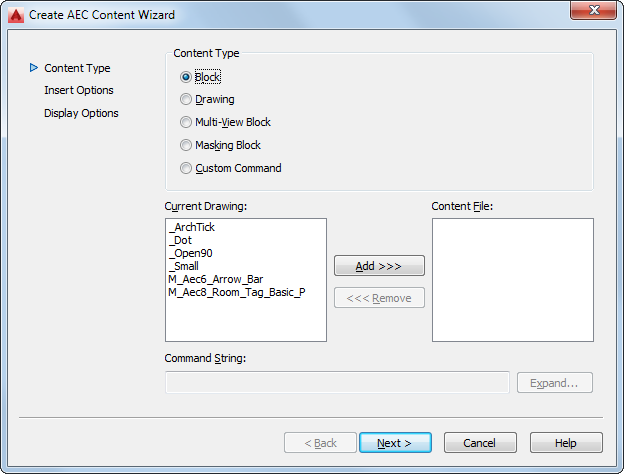

The AEC Content Wizard helps you create custom content. You can create blocks, drawings, and commands from data existing in the current drawing.
AEC Content Wizard
To create custom content, you first select the content type. Next, you specify options to be used when content is inserted into a drawing. The final step is to specify the output file and other parameters that control how DesignCenter™ displays the content.
When creating content in an existing AEC file (that is, a drawing generated from the AEC Content Wizard), the default values for each page of the wizard are set to the value used to create the drawing. The default settings provide an easy way for you to make small modifications to existing content files.
