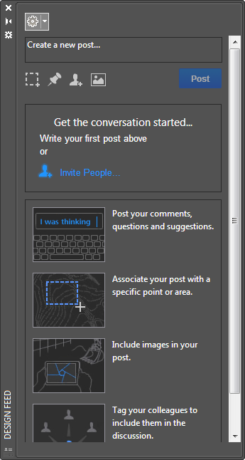

The Design Feed palette provides a way to post and reply to messages, which can include attached images, to colleagues and clients through Autodesk 360. The messages can be linked to locations and areas within the drawing, and can be accessed online by the people that you authorize.

Design Feed Buttons
Create a new post
You start creating a new post by typing your message in this field.
Associate this post to an area in the drawing
Click two diagonal points to define a dashed blue rectangle along with a design feed bubble. If the post is hidden or deleted, the rectangle and the bubble will also be hidden or deleted.
Associate this post to a point in the drawing
Click a point location at which to display a design feed bubble.
