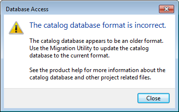

You can customize the catalog database by adding tables, adding records, editing records, and renaming column labels. But, some changes can stop the program from using the catalog database. When that happens you see this alert.
Follow these guidelines to make sure your changes do not stop the program from using the catalog database.
