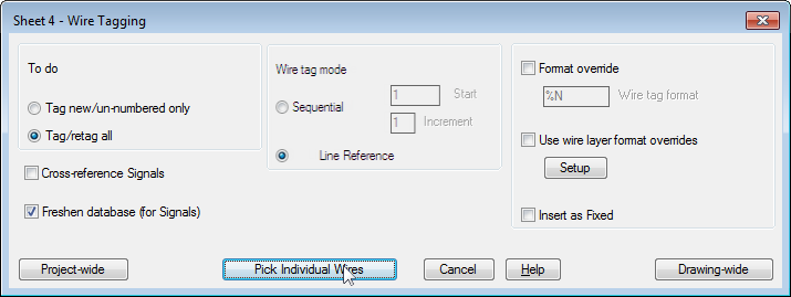

  5. Click Schematic tabInsert Wires/Wire Numbers panelInsert Wire Numbers drop-downWire Numbers. Find
  6. In the Sheet 4 - Wire Tagging dialog box, click Pick Individual Wires.
  7. Respond to the prompts as follows:
    Select objects: 
     Select the wire segment between the two push buttons on line reference 403 (1), right-click
    The wire number is placed.
Add wire numbers to the entire drawing
  1. Click Schematic tabInsert Wires/Wire Numbers panelInsert Wire Numbers drop-downWire Numbers. Find
  2. In the Sheet 4 - Wire Tagging dialog box, click Drawing-wide.
    Wire numbers are assigned to each segment in your drawing.

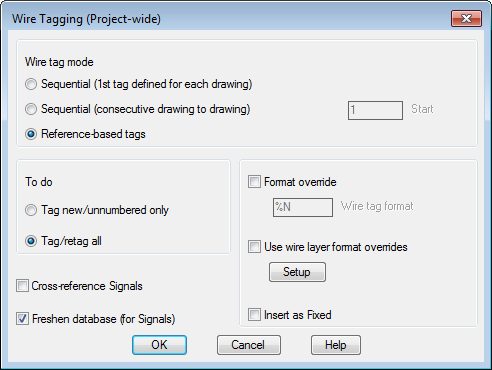

Add wire numbers project-wide
  2. In the Sheet 4 - Wire Tagging dialog box, click Project-wide.
  3. In the Wire Tagging (Project-wide) dialog box, verify:
    Wire tag mode:  Reference-based tags
    To do:  Tag/retag all
    Freshen database (for Signals)
  4. Click OK.
  5. In the Select Drawings to Process dialog box, Project Drawing List section, press SHIFT as you select AEGS03.dwg and AEGSO04.dwg. Click Process.
  6. Verify AEGS03.dwg and AEGS04.dwg are listed as the drawings to process and click OK.
  7. If asked to save the drawing, click OK.
    Wire numbers are processed for the selected drawings.
