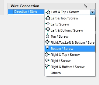

Back on the Symbol Builder Attribute Editor, expand the Wire Connection list and select Bottom/Screw.
Select the Insert Wire Connection tool and insert the terminal in the bottom center of the rectangle.
Select Right/Screw from the Wire Connection Direction/Style list.
Select the Insert Wire Connection tool and insert the terminal in the center of the right-hand side of the rectangle.

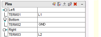

In the Pins section, enter “GND” in the TERM02 value, and “L2” in the TERM03 value.
