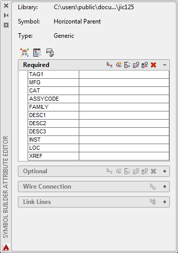

  1. If the Symbol Builder Attribute Editor is not visible,
    Click Symbol Builder tabEdit panelPalette Visibility Toggle. Find
    Use this palette to assign attributes to the rectangle as well as set the height and justification for each attribute. The palette displays the AutoCAD Electrical attributes that you can insert and define as part of the symbol. Once an attribute is inserted on the symbol a check mark displays next to it and you cannot insert it again. AutoCAD Electrical allows only one insertion of each attribute.
  2. In the Symbol Builder Attribute Editor, select TAG1 and click the Properties tool.

  3. Click the Insert Attribute tool.
    Insert the attribute above the rectangle.
    In the Symbol Builder Attribute Editor, notice the check mark next to the TAG1 attribute. Continue placing the rest of the attributes.
