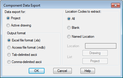

  1. Click Import/Export tabExport panelTo Spreadsheet. Find
  2. Select the data category to export.
    If you select General, information for the categories marked with an asterisk (*) is extracted. Each category is saved to a separate sheet (spreadsheet format) or table (database format). The tab-delimited or comma-delimited formats are not available when writing out to multiple categories.
  3. Click OK.
    Note: Options on the data export dialog box vary depending on the category selected.
  4. Specify to export the data for the current drawing or the entire project.
  5. Specify the output format.
  6. Select location codes to extract (if applicable).
    • All. Extracts all components regardless of location value.
    • Blank. Extracts only those components that do not have a location value.
    • Named. Extracts only those components that have a location value matching the value entered in the box. Wild-card characters are supported.
  7. Click OK.
    AutoCAD Electrical creates a file of the data extracted from your drawings.

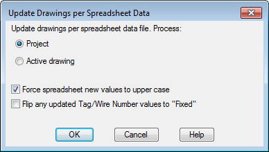

  12. Click Import/Export tabImport panelFrom Spreadsheet. Find
  13. Select the spreadsheet and click Open.
  14. Specify to import the spreadsheet data for the current drawing or the project.
  15. Select any other import options and click OK.
    Note: A block name change performs a block swap on import.
