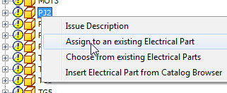

  1. Right-click PJ2 and select Assign to an existing Electrical Part.
    With reference to the AutoCAD Electrical drawing, PJ2 is the RefDes specified for the connector that connects to the motor MOT2, the motor for horizontal adjustment.
