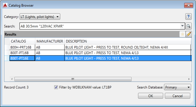

Use search to display catalog numbers selectively for a component type.
Search catalog data

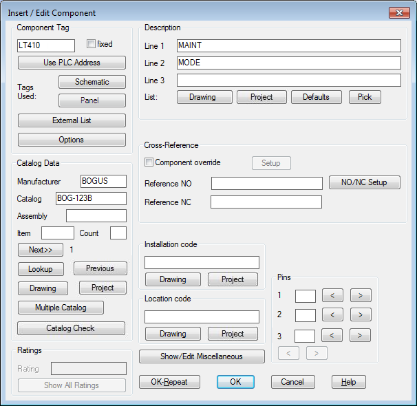

  1. Right-click LT410 and select Edit Component.
  2. In the Insert/Edit Component dialog box, Catalog Data section, click Lookup.
  3. Enter the search AB 30.5mm "120VAC XFMR" and click .
  4. Change the catalog assignment to 800T-PT16E.

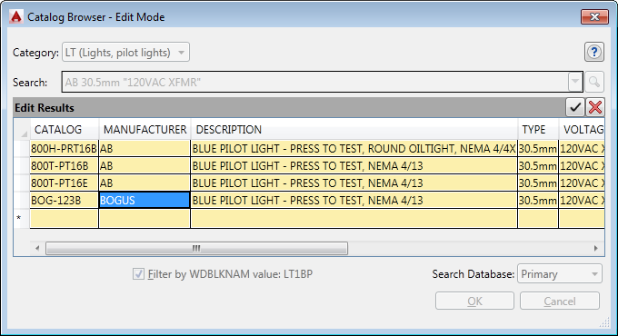

Add a catalog entry

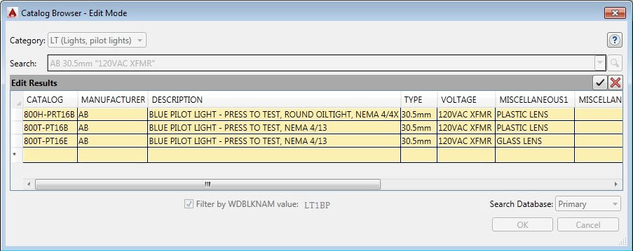

  1. In the Catalog Browser dialog box, click to start the edit mode.
  2. Right-click on the row for catalog 800T-PT16E and select Copy row.
  3. Right-click in the blank row at the bottom and select Paste.
  4. Click the Catalog cell and enter BOG-123B.
  5. Click the Manufacturer cell and enter BOGUS.
  6. Click to save the changes.
  7. Change the search to BOGUS 30.5mm "120VAC XFMR" and click .
  8. Select the BOG-123B catalog entry and click OK.
  9. In the Insert/Edit Component dialog box, click OK.
