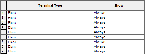

    You now have a new blank input module with nine terminals and eight addressable I/O points. You now need to define some information for each terminal in the module, the most important being what symbols AutoCAD Electrical should stack together to build the module. Usually the top-most symbol for the module is a little different from the rest so that it can carry some basic information for the module that only needs to occur once in the final symbol.
Assigning Terminal Types
  1. In the PLC Database File Editor dialog box, right-click Terminal Type 1 and select Edit Terminal from the context menu.

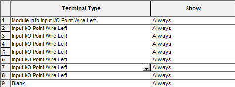

  4. In the PLC Database File Editor dialog box, multiple-select the next seven terminals, right-click, and select Edit Terminal.
    Note: You can select multiple fields to edit at the same time by dragging your mouse across contiguous fields or by holding down the Control key while selecting non-contiguous fields.

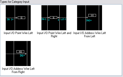

  5. In the Select Terminal Information dialog box, select the Input category and look at the available terminals.
  6. Select the Input I/O Point Wire Left terminal and click OK.
    All seven terminals are assigned at the same time.
  7. In the PLC Database File Editor dialog box, right-click on the last terminal and select Edit Terminal.
  8. In the Select Terminal Information dialog box, select the Terminal category.
  9. Click the Terminal Point Wire Right terminal and click OK.
As an alternative to the Select Terminal Information dialog box, you can use the drop-down list of predetermined Terminal Types. Click the arrow for the Terminal Type and select from the list of available terminal types.
