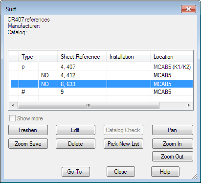

  5. Click Projects tabOther Tools panelSurfer drop-downSurfer. Find
  6. Click anywhere on relay coil CR407.
    All instances of CR407 appear in the Surf dialog box.
  7. Select the reference on sheet 6.
  8. Click Go To.
    The instance of CR407 on sheet 6 is surfed to and displayed in the drawing next to the Surf dialog box.
  9. Select the reference on sheet 9.
  10. Click Go To.

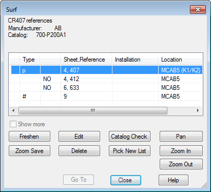

    You can edit or delete the component using options in the Surf dialog box.
  11. Double-click the first entry in the Surf dialog box to return to the original AEGS04.dwg drawing.
  12. Click Close.
