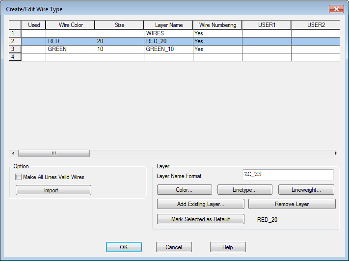

  1. Click Schematic tabEdit Wires/Wire Numbers panelCreate/Edit Wire Type. Find
  2. In the Create/Edit Wire Type dialog box, specify:
    Wire Color:  RED
    The Layer Name is automatically created. The name RED_20 is assigned to the wire layer you are creating.
  3. Click Color.
  4. In the Select Color dialog box, select red and click OK.
  5. Click Linetype.
  6. In the Select Linetype dialog box, select Continuous and click OK.
  7. In the Create/Edit Wire Type dialog box, specify:
    Wire Color:  GREEN
    Color:  Green
    Linetype:  Hidden2
    Note: If HIDDEN2 is not available, click Load. Select it from the list of line types on the Load or Reload Linetypes dialog box.
  8. Select RED_20 in the grid and click Mark Selected as Default.
  9. Click OK.
