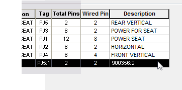

  3. The connector you added in Inventor is listed in the Connector Selection dialog box. Select the row for the connector.

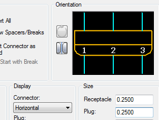

  4. At the bottom of the dialog box, click Details.
  5. On the connector display menu, click Horizontal.
    The display in the dialog box switches to horizontal.
  6. Click Insert.
