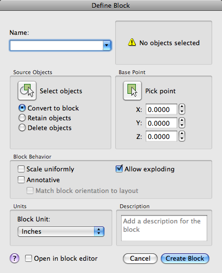

Define Block Dialog Box
Defines and names a block.
List of Options
The following options are displayed.
Name
Names the block. The name can have up to 255 characters and can include letters, numbers, blank spaces, and any special character not used by the operating system or the program for other purposes.
The block name and definition are saved in the current drawing.
Preview
If an existing block is selected under Name, displays a preview of the block.
Source Objects
Specifies the objects to include in the new block and whether to retain or delete the selected objects or convert them to a block instance after you create the block.
Specify On-Screen
Prompts you to specify the objects when the dialog box is closed.
Select Objects
Closes the Block Definition dialog box temporarily while you select the objects for the block. When you finish selecting objects, press Enter to return to the dialog box.
Convert to Block
Converts the selected objects to a block instance in the drawing after you create the block.
Retain Objects
Retains the selected objects as distinct objects in the drawing after you create the block.
Delete Objects
Deletes the selected objects from the drawing after you create the block.
Objects Selected
Displays the number of selected objects.
Base Point
Specifies an insertion base point for the block. The default value is 0,0,0.
Specify On-Screen
Prompts you to specify the base point when the dialog box is closed.
Pick Insertion Base Point
Temporarily closes the dialog box so that you can specify an insertion base point in the current drawing.
X
Specifies the X coordinate value.
Y
Specifies the Y coordinate value.
Z
Specifies the Z coordinate value.
Block Behavior
Specifies the behavior of the block.
Scale Uniformly
Specifies whether or not the block reference is prevented from being non-uniformly scaled.
Annotative
Specifies that the block is annotative.
Match Block Orientation to Layout
Specifies that the orientation of the block references in paper space viewports matches the orientation of the layout. This option is unavailable if the Annotative option is cleared.
Allow Exploding
Specifies whether or not the block reference can be exploded.
Units
Specifies units for the block.
Block Unit
Specifies the insertion units for the block reference.
Description
Specifies the text description of the block.
Open in Block Editor
Opens the current block definition in the Block Editor when the dialog box is closed.
