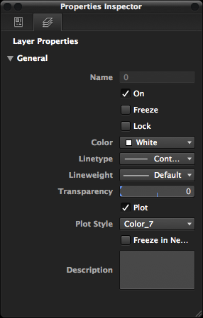

Current Properties
Layer Properties
Summary

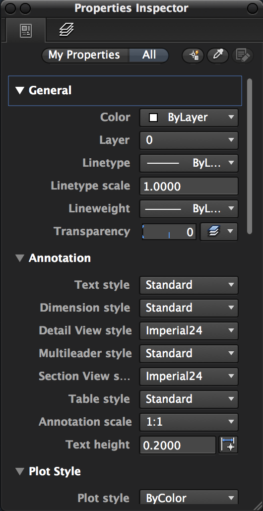

When more than one object is selected, only those properties common to all selected objects are displayed. When no objects are selected, only the current settings of general properties are displayed.
You can specify a new value to modify any property that can be changed. Click the value and use one of the following methods:

Current
Displays the properties for the current drawing or selected objects.
Layer
Displays the properties for the layer selected in the Layer list of the Layers palette.
Object Type
Displays the type of objects that are selected and filters which objects you are modifying.
My Properties tab
Displays your personalized list of properties that you selected using the Customize My Properties button.
All tab
Displays all the properties associated with the current drawing or the selected objects.
Match Properties
Applies the properties of a selected object to other objects.
