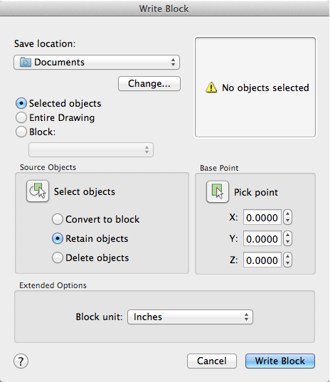

Write Block Dialog Box
Saves objects or converts a block to a file.
Summary
The Write Block dialog box displays different default settings depending on whether nothing is selected, a single block is selected, or objects other than blocks are selected.
List of Options
The following options are displayed.
Save Location
Specifies the new name and location of the file and the units of measurement to be used when the block is inserted.
File Name and Path
Specifies a file name and path where the block or objects will be saved.
Browse
Displays a standard file selection dialog box.
Preview
Displays a preview of the objects selected to be written to a drawing file.
Creation
Specifies blocks and objects, saves them as a file, and specifies insertion points.
Selected Objects
Selects objects to save as a file. Specify a base point and select objects below.
Entire Drawing
Selects current drawing to save as another file.
Block
Specifies an existing block to save as a file. Select a name from the list.
Source Objects
Sets the effect of block creation on objects used to create a block.
Select Objects Button
Temporarily closes the dialog box so that you can select one or more objects to save to the file.
Convert to Block
Converts the selected object or objects to a block in the current drawing after saving them as a file.
Retain objects
Retains the selected objects in the current drawing after saving them as a file.
Delete objects
Deletes the selected objects from the current drawing after saving them as a file.
Base Point
Specifies a base point for the block. The default value is 0,0,0.
Pick Point
Temporarily closes the dialog box so that you can specify an insertion base point in the current drawing.
X
Specifies the X coordinate value for the base point.
Y
Specifies the Y coordinate value for the base point.
Z
Specifies the Z coordinate value for the base point.
Extended Options
Blocks Unit
Specifies the unit value to be used for automatic scaling when the new file is inserted as a block in a drawing that uses different units. Select Unitless if you do not want to automatically scale the drawing when you insert it. See INSUNITS.
