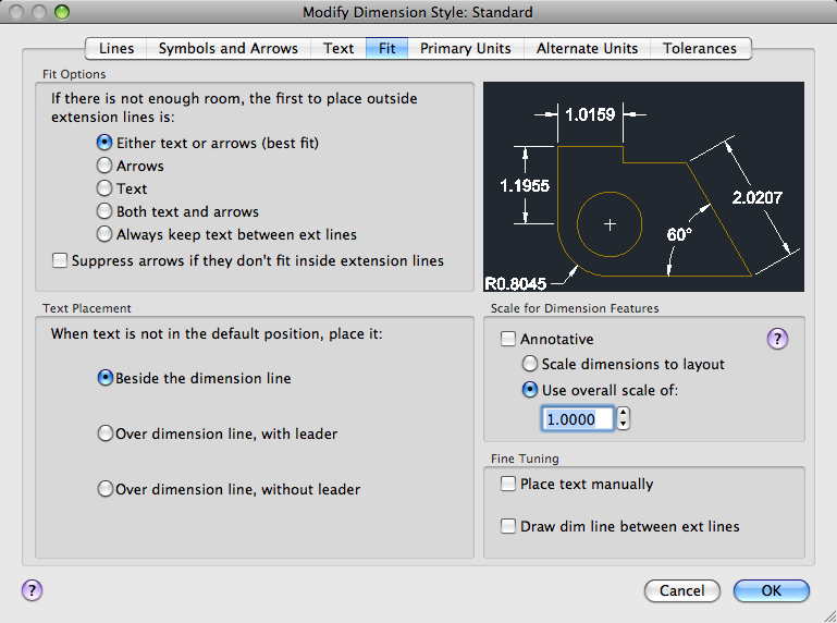

Fit Tab
Controls the placement of dimension text, arrowheads, leader lines, and the dimension line.
List of Options
The following options are displayed.
Fit Options
Controls the placement of text and arrowheads based on the space available between the extension lines.
When space is available, text and arrowheads are placed between the extension lines. Otherwise, text and arrowheads are placed according to the Fit options. (DIMATFIT, DIMTIX, and DIMSOXD system variables)
Either Text or Arrows (Best Fit)
Moves either the text or the arrowheads outside the extension lines based on the best fit (DIMATFIT system variable).
  • When enough space is available for text and arrowheads, places both between the extension lines. Otherwise, either the text or the arrowheads are moved based on the best fit.
  • When enough space is available for text only, places text between the extension lines and places arrowheads outside the extension lines.
  • When enough space is available for arrowheads only, places them between the extension lines and places text outside the extension lines.
  • When space is available for neither text nor arrowheads, places them both outside the extension lines.
Arrows
Moves arrowheads outside the extension lines first, then text (DIMATFIT system variable).
  • When space is available for arrowheads only, places them between the extension lines and places text outside them.
  • When not enough space is available for arrowheads, places both text and arrowheads outside the extension lines.
Text
Moves text outside the extension lines first, then arrowheads (DIMATFIT system variable).
  • When space is available for text and arrowheads, places both between the extension lines.
  • When space is available for text only, places the text between the extension lines and places arrowheads outside them.
  • When not enough space is available for text, places both text and arrowheads outside the extension lines.
Both Text and Arrows
When not enough space is available for text and arrowheads, moves both outside the extension lines (DIMATFIT system variable).
Always Keep Text Between Ext Lines
Always places text between extension lines. (DIMTIX system variable)
Suppress Arrows If They Don't Fit Inside Extension Lines
Suppresses arrowheads if not enough space is available inside the extension lines. (DIMSOXD system variable)
Text Placement
Sets the placement of dimension text when it is moved from the default position, that is, the position defined by the dimension style. (DIMTMOVE system variable)
Beside the Dimension Line
If selected, moves the dimension line whenever dimension text is moved. (DIMTMOVE system variable)
Over the Dimension Line, with Leader
If selected, dimension lines are not moved when text is moved. If text is moved away from the dimension line, a leader line is created connecting the text to the dimension line. The leader line is omitted when text is too close to the dimension line. (DIMTMOVE system variable)
Over the Dimension Line, Without Leader
If selected, dimension lines are not moved when text is moved. Text that is moved away from the dimension line is not connected to the dimension line with a leader. (DIMTMOVE system variable)
Scale for Dimension Features
Sets the overall dimension scale value or the paper space scaling.
Annotative
Specifies that the dimension is annotative. Click the information icon to learn more about annotative objects.
Scale Dimensions To Layout
Determines a scale factor based on the scaling between the current model space viewport and paper space. (DIMSCALE system variable)
When you work in paper space, but not in a model space viewport, or when TILEMODE is set to 1, the default scale factor of 1.0 is used or the DIMSCALE system variable.
Use Overall Scale Of
Sets a scale for all dimension style settings that specify size, distance, or spacing, including text and arrowhead sizes. This scale does not change dimension measurement values. (DIMSCALE system variable)
Fine Tuning
Provides additional options for placing dimension text.
Place Text Manually
Ignores any horizontal justification settings and places the text at the position you specify at the Dimension Line Location prompt. (DIMUPT system variable)
Draw Dim Line Between Ext Lines
Draws dimension lines between the measured points even when the arrowheads are placed outside the measured points. (DIMTOFL system variable)
Preview
Displays sample dimension images that show the effects of changes you make to dimension style settings.
