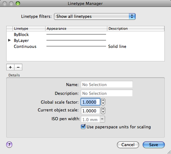

Linetype Manager
Loads linetypes and sets the current linetype.
List of Options
The following options are displayed.
Linetype Filters
Determines which linetypes to display in the linetype list. You can filter linetypes based on whether they are xref-dependent, or whether they are referenced by objects.
List of Linetypes
Displays the loaded linetypes according to the option specified in Linetype Filters. To quickly select all or clear all linetypes, right-click in the linetype list to display the shortcut menu.
Current
Indicates which linetype is current.
Double-click a linetype to set it as the current linetype. Setting the current linetype to BYLAYER means that an object assumes the linetype that is assigned to a particular layer. Setting the linetype to BYBLOCK means that an object assumes the CONTINUOUS linetype until it is grouped into a block. Whenever the block is inserted, all objects inherit the block's linetype. The CELTYPE system variable stores the linetype name.
Linetype
Displays names of loaded linetypes. To rename a linetype, select it and then click it again and enter a new name. BYLAYER, BYBLOCK, CONTINUOUS, and xref-dependent linetypes cannot be renamed.
Appearance
Displays a sample of selected linetypes.
Description
Displays descriptions of the linetypes, which can be edited in the Details area.
Load (+)
Displays the Load or Reload Linetypes dialog box, in which you can load into the drawing selected linetypes from the acad.lin file and add them to the linetype list.
Delete (-)
Deletes selected linetypes from the drawing. You can delete only unused linetypes. The BYLAYER, BYBLOCK, and CONTINUOUS linetypes cannot be deleted.
Note: Be careful about deleting linetypes if you are working on a drawing in a shared project or one based on a set of layering standards. The deleted linetype definition remains stored in the acad.lin or acadiso.lin file and can be reloaded.
Details
Provides alternative access to properties and additional settings.
Name
Displays the selected linetype name, which can be edited.
Description
Displays the description of the selected linetype, which can be edited.
Global Scale Factor
Displays the global scale factor for all linetypes. (LTSCALE system variable)
Current Object Scale
Sets linetype scale for newly created objects. The resulting scale is the global scale factor multiplied by the object's scale factor. (CELTSCALE system variable)
ISO Pen Width
Sets the linetype scale to one of a list of standard ISO values. The resulting scale is the global scale factor multiplied by the object's scale factor.
Use Paper Space Units for Scaling
Scales linetypes in paper space and model space identically. Useful when working with multiple viewports. (PSLTSCALE system variable)
