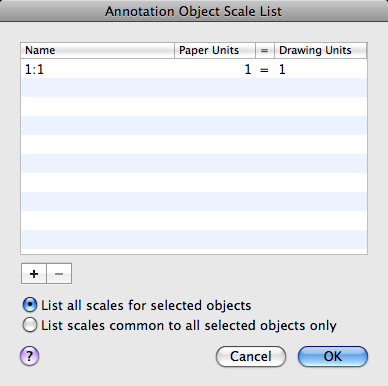

Annotation Object Scale List Dialog Box
Adds or deletes supported scales for the selected annotative object.
List of Options
The following options are displayed.
Object Scale List
Displays the list of scales supported by the selected object.
List all scales for selected objects
Specifies that all scales supported by the selected objects are displayed in the Object Scale List.
List scales common to all selected objects only
Specifies that only the supported scales that are common to all selected objects are displayed in the Object Scale List.
Add (+)
Displays the Add Scales to Object Dialog Box.
Delete (-)
Removes the selected scale from the scale list.
Note: The current scale or scales referenced by objects or views cannot be deleted.
