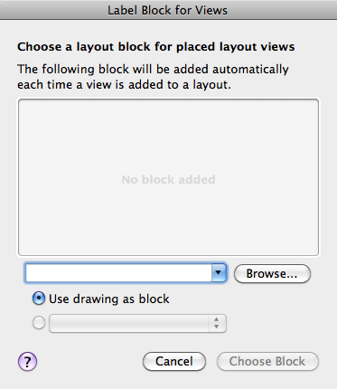

Adds a new label block for use in the current project.
The following options are displayed.
Displays a preview image when a block is selected.
Specifies the path and name of a drawing (DWG) file or the name and path of a drawing template (DWT) file to be used as the source of a block definition.
Click Browse to display the Select Drawing dialog box and select the drawing file to use.
Use the entire specified drawing or drawing template file as the block definition.
Use a selected block definition from the specified drawing or drawing template file.
