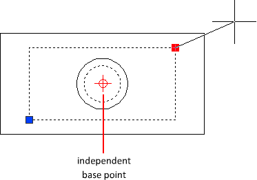

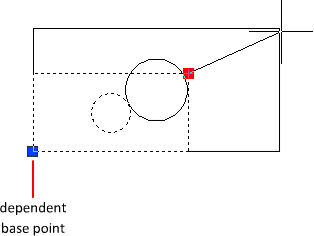

Base Type
Specifies whether the base point for the action is dependent or independent of the associated parameter’s base point.
Dependent
Scales or moves selected objects relative to the base point of the associated parameter.
Independent
Scales or moves selected objects relative to a base point defined separately from that of the associated parameter.

Base Type
Specifies whether the base point for the action is dependent or independent.
