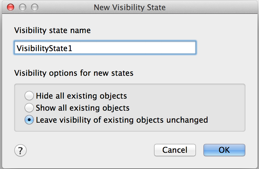

New Visibility State Dialog Box
Creates a new visibility state.
List of Options
The following options are displayed.
Visibility State Name
Specifies the name for the new visibility state.
Visibility Options for New States
Displays options for the new visibility state.
Hide All Existing Objects
Specifies that all objects in the block definition will be hidden in the new visibility state.
Show All Existing Objects
Specifies that all objects in the block definition will be shown in the new visibility state.
Leave Visibility of Existing Objects Unchanged
Specifies that the visibility of objects in the new visibility state will be the same as in the current visibility state on which the new state is based.
