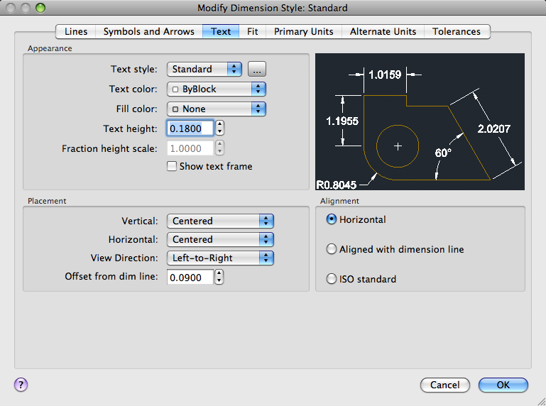

Sets the format, placement, and alignment of dimension text.
The following options are displayed.
Controls the dimension text format and size.
Lists the available text styles.
Displays the Text Style Dialog Box where you can create or modify text styles. (DIMTXSTY system variable)
Sets the color for the dimension text. If you click Select Color (at the bottom of the Color list), the Color Palette dialog box is displayed. You can also enter color name or number. (DIMCLRT system variable)
Sets the color for the text background in dimensions. If you click Select Color (at the bottom of the Color list), the Color Palette dialog box is displayed. You can also enter color name or number. (DIMTFILL and DIMTFILLCLR system variables)
Sets the height of the current dimension text style. Enter a value in the text box. If a fixed text height is set in the Text Style (that is, the text style height is greater than 0), that height overrides the text height set here. If you want to use the height set on the Text tab, make sure the text height in the Text Style is set to 0. (DIMTXT system variable)
Sets the scale of fractions relative to dimension text. This option is available only when Fractional is selected as the Unit Format on the Primary Units tab. The value entered here is multiplied by the text height to determine the height of dimension fractions relative to dimension text. (DIMTFAC system variable)
When selected, draws a frame around dimension text. Selecting this option changes the value stored in the DIMGAP system variable to a negative value.

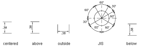

Controls the placement of dimension text.
Controls the vertical placement of dimension text in relation to the dimension line. (DIMTAD system variable)
Vertical position options include the following:
Controls the horizontal placement of dimension text along the dimension line, in relation to the extension lines. (DIMJUST system variable)
Horizontal position options include the following:

Sets the current text gap, which is the distance around the dimension text when the dimension line is broken to accommodate the dimension text.
This value is also used as the minimum length required for dimension line segments.
Text is positioned inside the extension lines only if the resulting segments are at least as long as the text gap. Text above or below the dimension line is placed inside only if the arrowheads, dimension text, and a margin leave enough room for the text gap. (DIMGAP system variable)
Controls the orientation (horizontal or aligned) of dimension text whether it is inside or outside the extension lines. (DIMTIH and DIMTOH system variables)
Places text in a horizontal position.
Aligns text with the dimension line.
Aligns text with the dimension line when text is inside the extension lines, but aligns it horizontally when text is outside the extension lines.
Displays sample dimension images that show the effects of changes you make to dimension style settings.
