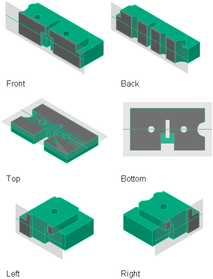

Orthographic
Aligns the section object to an orthographic orientation relative to the UCS.
A section object that contains all 3D objects is created with the specified orientation relative to the UCS (not the current view). This option creates a section object in the Section Plane state with live sectioning turned on.
  • Align section to. Sets the position of the section object to align with one of the following UCS orientations that you specify:
    • Front
    • Back
    • Top
    • Bottom
    • Left
    • Right
