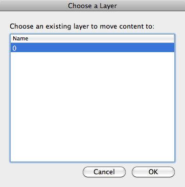

Choose a Layer Dialog Box
Merges selected layers to a specified layer.
List of Options
The following options are displayed.
Choose an existing layer to move content to
Lists the available layers in the current drawing that you can merge the selected layers with from the Layers palette. All objects on the selected layers from the Layers palette are moved to the specified layer and then the layers are removed from the drawing.
