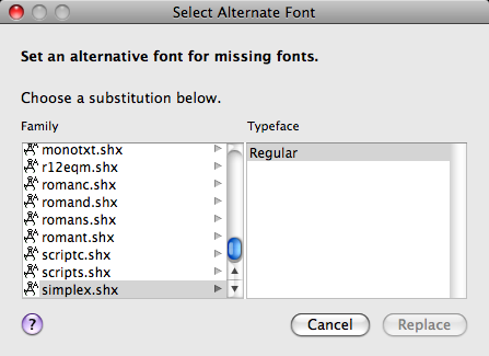

Select Alternate Font Dialog Box
Specifies the location of the font file to use if the original font cannot be located and an alternate font is not specified in the font mapping file.

Font Name
Lists the font family name for all registered TrueType fonts and all SHX fonts in the Fonts folder.
Font Style
Specifies font character formatting, such as italic, bold, or regular. If the missing font is a Big Font, this option changes to Big Font and lists all available Asian-language Big Font files.
