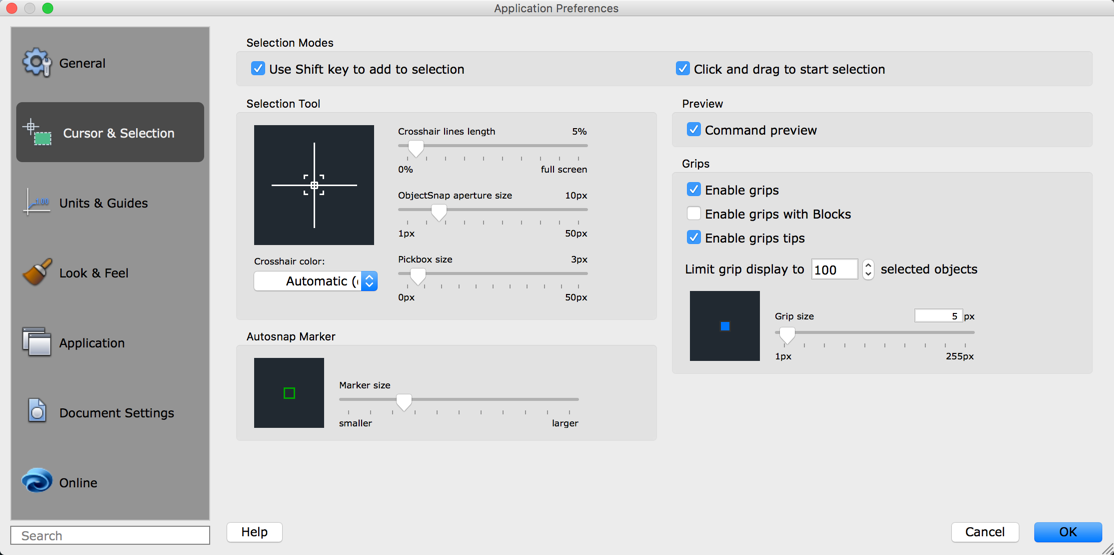

Controls the appearance and behavior of the cursor and selection.
The following options are displayed.
Controls the selection of objects in the drawing area.
Controls whether subsequent selections replace the current selection set or add to it.
To clear a selection set quickly, draw a selection window in a blank area of the drawing. (PICKADD system variable)
Controls the method of drawing a selection window.
If this option is cleared, you can draw a selection window by selecting two separate points with the pointing device. (PICKDRAG system variable)
Controls the appearance of the cursor in the drawing area.
Shows a representation of how the crosshair, ObjectSnap aperture, and pickbox will appear in the drawing area.
Controls the color of the crosshair, ObjectSnap aperture, and pickbox in the drawing area. Automatic is the default color.
When set to Automatic, the actual color applied changes between white and black based on the background color of the drawing area.
Determines the size of the crosshairs as a percentage of the screen size.
Valid settings range from 1 to 100 percent. When set to 100, the crosshairs are full-screen and the ends of the crosshairs are never visible. When less than 100, the ends of the crosshairs may be visible when the cursor is moved to one edge of the screen. (CURSORSIZE system variable)
Sets the display size for the object snap target box, in pixels.
Aperture size determines how close to a snap point you can be before the magnet locks the aperture box to the snap point. Values range from 1 to 50 pixels. (APERTURE system variable)
Sets the object selection target height, in pixels. (PICKBOX system variable)
Controls the appearance of the Autosnap Marker.
Sets the display size for the AutoSnap marker.
Shows you exactly how the objects would look when the command is executed. As you made the changes within the command, you can instantly preview the final result.
Activates the preview option.
Grips are small squares displayed on an object after it has been selected.
Controls the display of grips on selected objects. You can edit an object with grips by selecting a grip and using the shortcut menu. Displaying grips in a drawing significantly affects performance. Clear this option to optimize performance. (GRIPS system variable)
Controls the display of grip tips and Ctrl-cycling tooltips. (GRIPBLOCK system variable)
Controls the display of grip tips and Ctrl-cycling tooltips. This option has no effect on standard objects. (GRIPTIPS system variable)
Suppresses the display of grips when the selection set includes more than the specified number of objects. The valid range is 1 to 32,767. The default setting is 100. (GRIPOBJLIMIT system variable)
Sets the size of the grip box in pixels. (GRIPSIZE system variable)
