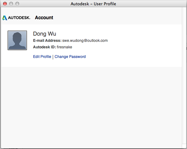

Controls settings of your Autodesk 360 account information.
The following options are displayed.
