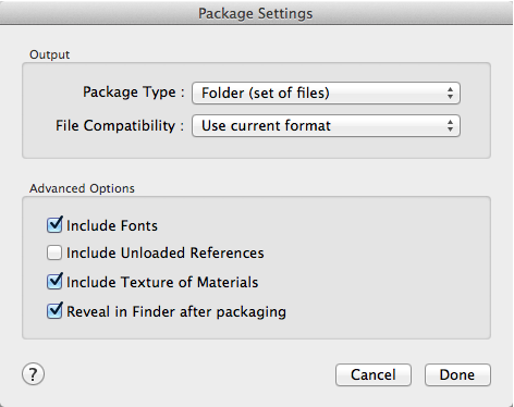

Specifies additional options to configure the transmittal package output.
Provides additional configuration settings for packages.
The following options are displayed.
Specifies whether to export the entities that are selected in the drawing or the entities that are visible in the current viewport. Only the entities that are specified under Export by Type are eligible to be exported.
Specifies which entities are eligible to be exported.
Provides you with two options to package files as: Compressed File (*.zip) or Folder (set of files). Selecting Compressed File packages your files in a zip format. Selecting Folder (set of files) saves all the selected files in a folder.
Provides you with options to make package compatible with previous versions of AutoCAD.
Specifies how to export a material’s texture.
Includes associated fonts in the package.
Includes external references that are unloaded from the current drawing.
Includes texture of materials in the package.
Opens the Finder window revealing the package location.
