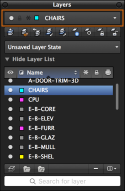

Use the Layers palette to manage your layers.

All new objects are drawn on the current layer. The current layer is indicated in the Layers palette.
