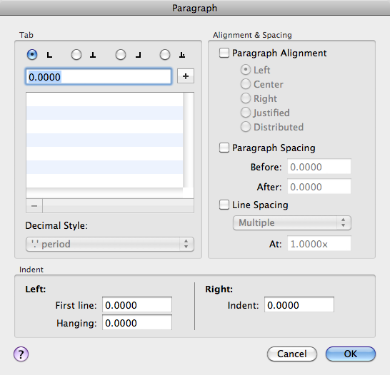

Paragraph Dialog Box
Sets indentation for paragraphs and the first lines of paragraphs.
Summary
Specifies tab stops, indents, controls paragraph alignment, paragraph spacing, and paragraph line spacing.
Note: Not all of the new options for paragraph and paragraph line spacing are supported in AutoCAD 2007 and previous releases. See MTEXT Paragraph and Paragraph Line Spacing in Previous Releases in the User’s Guide.
List of Options
The following options are displayed.
Tab
Specifies the tab stops and decimal styles to use for the paragraph.
Tab Stops
Displays tab setting options, including adding and removing tabs. Options include setting left, center, right, and decimal tabs. You can also set tabs from the Tab selection button on the In-Place Editor’s ruler.
Decimal style
Sets the decimal style based on current user locale. Options include setting the decimal style as period, comma, and space. This setting is preserved with the drawing even if the locale setting is changed.
Indent
Controls the left and right indents for the paragraph.
Left
Sets the indent value for the first line or hanging indent to the selected or current paragraphs.
Right
Applies the indent to the entire selected or current paragraph.
Alignment & Spacing
Defines the alignment and spacing for the paragraph.
Paragraph Alignment
Sets the alignment properties for the current or selected paragraphs.
Paragraph Spacing
Specifies the spacing before or after the current or selected paragraphs. The distance between two paragraphs is determined by the total of the after paragraph spacing value of the upper paragraph and the before paragraph spacing value of the lower paragraph.
Line Spacing
Sets the spacing between individual lines in the current or selected paragraphs.
