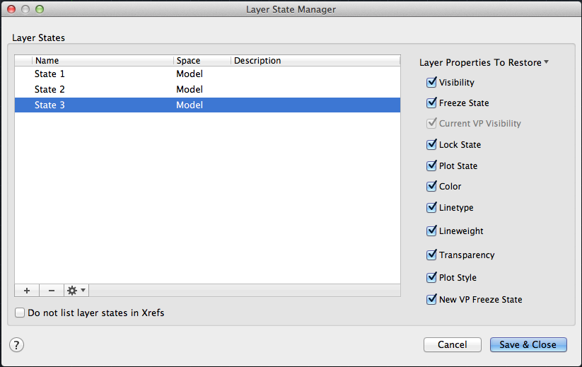

Layer States Manager
Saves, restores, and manages sets of layer settings that are called layer states.
Summary
Displays a list of saved layer states in the drawing. You can create, rename, edit, and delete layer states.
List of Options
The following options are displayed.
Layer States
Lists the layer states that have been saved in the drawing.
Do Not List Layer States in Xrefs
Controls whether layer states in xrefs are displayed.
Save & Close
Saves the settings and closes the Layer States Manager.
More Options
Layer Properties to Restore
Applies only the specified layer property settings when the specified layer state is restored. Click the Layer Properties to Restore drop-down menu to view the Select All and Clear All options.
Select All
Selects all the layer property settings.
Clear All
Clears all the layer property settings.
