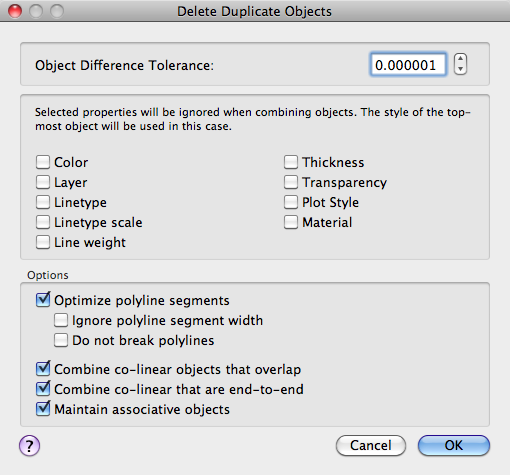

Delete Duplicate Objects Dialog Box
Removes duplicate geometry as well as overlapping lines, arcs, and polylines. Also, combines partially overlapping or contiguous ones.
List of Prompts
The following options are displayed.
Object Difference Tolerance
Controls the precision with which OVERKILL makes numeric comparisons. If this value is 0, the two objects being compared must match before OVERKILL modifies or deletes one of them.
Ignore Object Property:
Use these settings to determine which object properties are ignored during comparison.
Color
Object color is ignored.
Layer
Object layers are ignored.
Linetype
Object linetypes are ignored.
Linetype Scale
Object linetype scale is ignored.
Lineweight
Object lineweight is ignored.
Thickness
Object thickness is ignored.
Transparency
Object transparency is ignored.
Plot style
Object plot style is ignored.
Material
Object material is ignored.
Options
Use these settings to control how OVERKILL deals with lines, arcs, and polylines.
Optimize polyline segments
When selected, individual line and arc segments within selected polylines are examined. Duplicate vertices and segments are removed.
Also, OVERKILL compares individual polyline segments with completely separate line and arc segments. If a polyline segment duplicates a line or arc object, one of them is deleted.
If this option is not selected, polylines are compared as discreet objects and two sub-options are not selectable.
  • Ignore polyline segment width. Ignores segment width, while optimizing polyline segments.
  • Do not break polylines. Polyline objects are unchanged.
Combine co-linear objects that partially overlap
Overlapping objects are combined into single objects.
Combine co-linear objects when aligned end-to-end
Objects that have common endpoints are combined into single objects.
Maintain associative objects
Associative objects are not deleted or modified.
