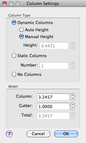

Column Settings Dialog Box
Displays options for setting up columns such as the type, number of columns, height, and width, and gutter size.
List of Options
The following options are displayed.
Column Type
Lists choices for the type of columns you want to create.
Height
Displays the height of the multiline text object when Auto Height with Dynamic or Static Columns is selected.
Number
Sets the number of columns. This is only active when you select Static Columns.
Width
Displays and specifies control column and gutter width values. The gutter value is five times the default multiline text height.
Also displays the total width value of the multiline text object.
