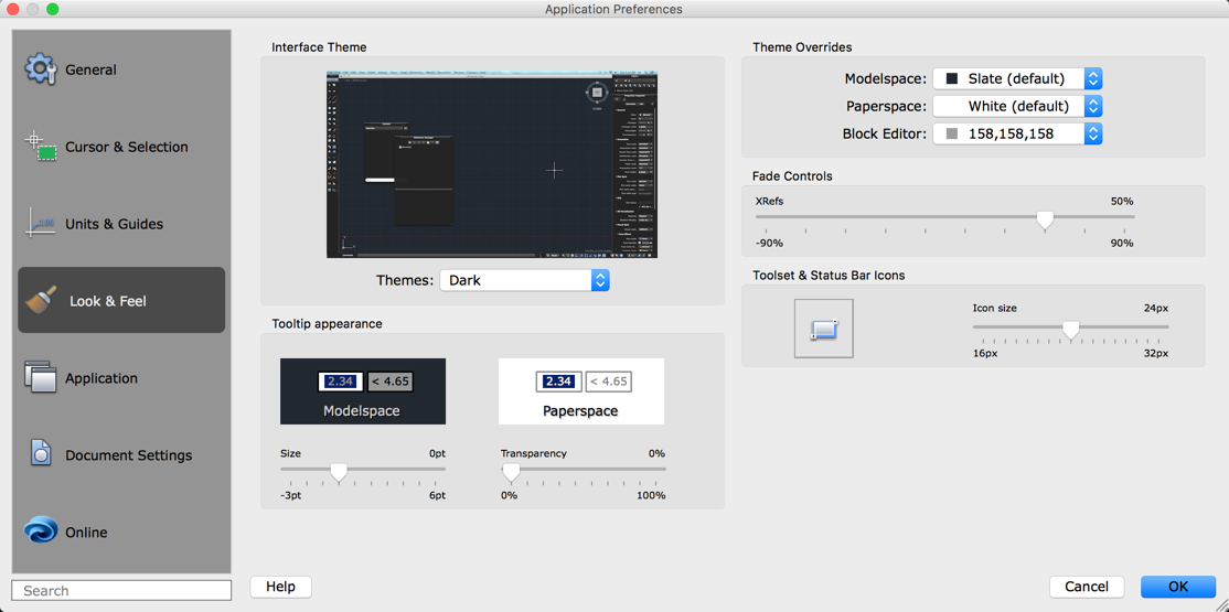

Controls the appearance of the program user interface.
The following options are displayed.
Defines the color scheme for the user interface.
Controls which theme to apply to elements such as the status bar, palettes, and the drawing windows. You can choose from a Dark or Light theme.
Controls the appearance of drafting tooltips.
Specifies a size for tooltips. The default size is 0. Use the slider to make tooltips larger or smaller.
Controls the transparency of tooltips. The lower the setting, the less transparent the tooltip. A value of 0 sets the tooltip to opaque.
Overrides used to fine tune the colors applied to the background of the drawing area.
Specifies the background color of the drawing area when the Model layout is active. Choose a color or Select Color to specify one of the non-standard colors.
Specifies the background color of the drawing area when a named (paper space) layout is active.
Specifies the background color of the drawing area when the Block Editor environment is active.
Controls the fading intensity value for xrefs.
Controls the dimming for all DWG xref objects. (XDWGFADECTL system variable)
This option only affects the display on the screen. It does not affect plotting or plot preview.
Controls the size of the icons used in parts of the user interface.
Specifies the size of the icons displayed on the Tool Sets palette and status bar. (ICONSIZE system variable)
