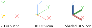

Variations in UCS Icon Types
The UCS icon is displayed in various ways to help you visualize the orientation of the work plane. The following figure shows some of the possible icon displays.
You can use the UCSICON command to switch between the 2D UCS icon and the 3D UCS icon. You can also use the command to change the size, color, and icon line width of the 3D UCS icon.
