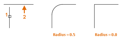

Set the Fillet Radius
The fillet radius determines the size of the arc created by the FILLET command, which connects two selected objects or the segments in a 2D polyline. Until you change it, the fillet radius applies to all subsequently created fillets.
Note: If the fillet radius is set to 0, the selected objects are trimmed or extended until they intersect; no arc is created. When the fillet radius is set to 0, you can remove the arc segment between two straight line segments or all arc segments from a 2D polyline.
  1. Click ModifyFillet.
  2. At the Command prompt, enter r (Radius).
  3. Enter a new fillet radius value.
    Once the fillet radius has been set, select the objects or line segments that define the points of tangency for the resulting arc or press Enter to end the command.
    Tip: Press and hold Shift while selecting objects or line segments to override the current fillet radius with a value of 0.
