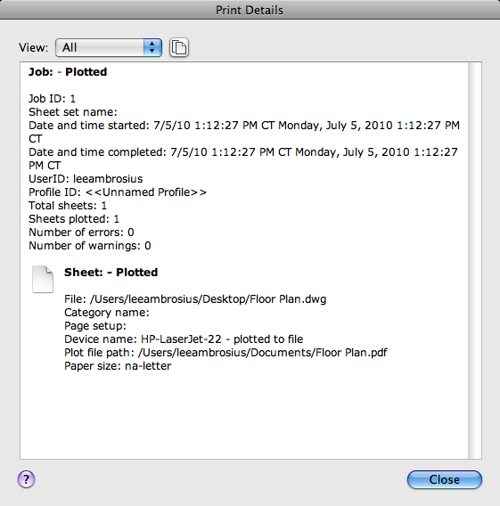

Displays information about plotting and publishing jobs that have been completed in the current session.
The following options are displayed.
Specifies what is displayed. You can also right-click in the details area and click View Errors Only or View All to change this setting.
Displays information about all completed print and publish jobs and sheets within those jobs.
Lists errors that have occurred as jobs were printed or published.
Copies all highlighted text to the Clipboard.
Lists details of completed print and publish jobs.
