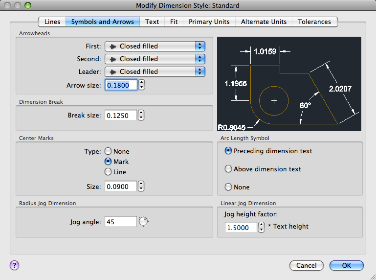

Symbols and Arrows Tab
Sets the format and placement for arrowheads, center marks, arc length symbols, and jogged radius dimensions.
Summary
Controls the appearance of the dimension arrowheads.
List of Options
The following options are displayed.
Arrowheads
First
Sets the arrowhead for the first dimension line. When you change the first arrowhead type, the second arrowhead automatically changes to match it. (DIMBLK1 system variable)
To specify a user-defined arrowhead block, select User Arrow. The Select Custom Arrow Block dialog box is displayed. Select the name of a user-defined arrowhead block. (The block must be in the drawing.)
Second
Sets the arrowhead for the second dimension line. (DIMBLK2 system variable)
Leader
Sets the arrowhead for the leader line. (DIMLDRBLK system variable)
Arrow Size
Displays and sets the size of arrowheads. (DIMASZ system variable)
Note: Annotative blocks cannot be used as custom arrowheads for dimensions or leaders.
Dimension Break
Controls the gap width of dimension breaks.
Break Size
Displays and sets the size of the gap used for dimension breaks.
Center Marks
Controls the appearance of center marks and centerlines for diameter and radial dimensions. The DIMCENTER, DIMDIAMETER, and DIMRADIUS commands use center marks and centerlines. For DIMDIAMETER and DIMRADIUS, the center mark is drawn only if you place the dimension line outside the circle or arc.
Type
Sets the type of center mark or line to use.
None
Creates no center mark or centerline. The value is stored as 0 in the DIMCEN system variable.
Mark
Creates a center mark. The size of the center mark is stored as a positive value in the DIMCEN system variable.
Line
Creates a centerline. The size of the centerline is stored as a negative value in the DIMCEN system variable.
Size
Displays and sets the size of the center mark or centerline. (DIMCEN system variable)
Radius Jog Dimension
Controls the display of jogged (zigzag) radius dimensions.
Jogged radius dimensions are often created when the center point of a circle or arc is located off the page.
Jog Angle
Determines the angle of the transverse segment of the dimension line in a jogged radius dimension. (DIMJOGANG system variable)
Arc Length Symbol
Controls the display of the arc symbol in an arc length dimension. (DIMARCSYM system variable)
Preceding Dimension Text
Places arc length symbols before the dimension text. (DIMARCSYM system variable)
Above Dimension Text
Places arc length symbols above the dimension text. (DIMARCSYM system variable)
None
Suppresses the display of arc length symbols. (DIMARCSYM system variable)
Linear Jog Dimension
Controls the display of the jog for linear dimensions.
Jog lines are often added to linear dimensions when the actual measurement is not accurately represent by the dimension. Typically the actual measurement is smaller than the desired value.
Jog Height Factor
Determines the height of the of the jog, which is determined by the distance between the two vertices of the angles that make up the jog.
Preview
Displays sample dimension images that show the effects of changes you make to dimension style settings.
