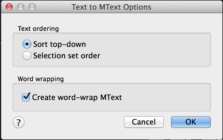

Text to MText Options Dialog Box
Converts one or more single-line text objects to a multiline text object.
List of Options
The following options are displayed:
Text ordering
Offers two options for ordering text: Sort top-down and Selection set order.
Sort top-down merges text from top to bottom sequence.
Selection set order merges in sequence of the way you selected the text objects.
Word wrapping
Selecting the Create word-wrap MText option wraps the text together.
