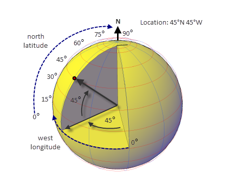

There are two types of GIS coordinates systems that are commonly used. They are geographic coordinate systems and projected coordinate systems.
Geographic coordinate systems take into account the curvature of the earth and a location is commonly specified in terms of longitude, latitude and elevation.
Because the earth is not perfectly round, no single geographic coordinate system is able to accurately define all locations on the surface of the Earth. Consequently, various organizations define local coordinate systems, where measurements are taken locally from a local datum.
