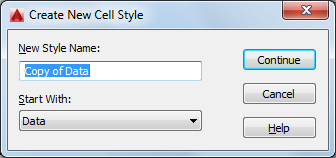

Specifies a name for the new cell style and specifies the existing cell style on which the new cell style will be based.
The following options are displayed.
Names the new cell style.
Specifies an existing cell style whose settings are the default for the new cell style.
Returns you to the New Table Style dialog box, in which you define the new cell style.
