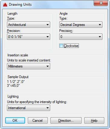

The following options are displayed.
Sets the current display format for units of measure.
The values include Architectural, Decimal, Engineering, Fractional, and Scientific. The Engineering and Architectural formats produce feet-and-inches displays and assume that each drawing unit represents one inch. The other formats can represent any real-world unit.
Sets the number of decimal places or fractional size displayed for linear measurements.
Specifies the current angle format and the precision for the current angle display.
Sets the current display format for angles.
Sets the precision displayed for angles.
The following conventions are used for the various angle measures:
Controls whether positive angles are measured in a clockwise or counterclockwise direction.
Controls the scale for blocks and drawings that are inserted into the current drawing.
If you insert a block or a drawing that is created with units that are different from the units used in the current drawing, the insertion scale value corrects the mismatch. If you do not want the block or drawing to be scaled, specify Unitless.
Displays an example of the current settings for units and angles.
Controls the unit of measurement for the intensity of photometric lights in the current drawing.
Displays the Direction Control dialog box.
