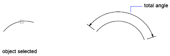

Sets the length of a selected object by specifying the total absolute length from the fixed endpoint. Total also sets the included angle of a selected arc by a specified total angle.
Lengthens the object to the specified value from the endpoint that is closest to the selection point.
Sets the included angle of the selected arc.
