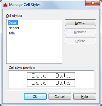

Displays all cell styles within the current table style and allows you to create or delete a cell style.
The following options are displayed.
Lists all cell styles contained within the current table style. The cell styles Title, Header, and Data are always contained within any table style.
Displays the Create New Cell Style dialog box. From here, you can create a new cell style to be contained within the current table style.
Allows you to give a new name to the selected cell style. The Title, Header, and Data cell styles cannot be renamed.
Allows you to delete the selected cell style.
Displays an example of the effect of the current cell style settings.
