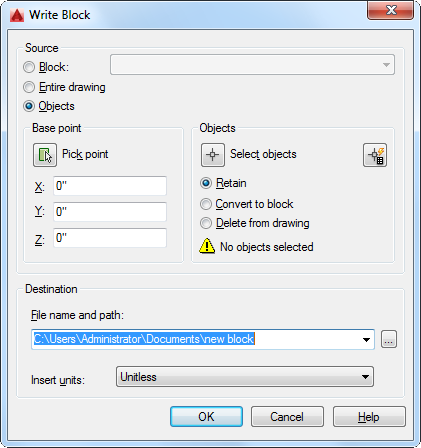

Saves selected objects or converts a block to a specified drawing file.
The Write Block dialog box provides a convenient method for saving part of the current drawing to a different drawing file, or saving a specified block definition as a separate drawing file.
The following options are displayed.
Specifies blocks and objects, saves them as a file, and specifies insertion points.
Specifies an existing block to save as a file. Select a name from the list.
Selects current drawing to save as another file.
Selects objects to save as a file. Specify a base point and select objects below.
Specifies a base point for the block. The default value is 0,0,0.
Temporarily closes the dialog box so that you can specify an insertion base point in the current drawing.
Specifies the X coordinate value for the base point.
Specifies the Y coordinate value for the base point.
Specifies the Z coordinate value for the base point.
Sets the effect of block creation on objects used to create a block.
Retains the selected objects in the current drawing after saving them as a file.
Converts the selected object or objects to a block in the current drawing after saving them as a file.
Deletes the selected objects from the current drawing after saving them as a file.
Temporarily closes the dialog box so that you can select one or more objects to save to the file.
Opens the Quick Select dialog box, which you can use to filter your selection set.
Indicates the number of objects selected.
Specifies the new name and location of the file and the units of measurement to be used when the block is inserted.
Specifies a file name and path where the block or objects will be saved.
Displays a standard file selection dialog box.
Specifies the unit value to be used for automatic scaling when the new file is dragged from DesignCenter ™ or inserted as a block in a drawing that uses different units. Select Unitless if you do not want to automatically scale the drawing when you insert it. See INSUNITS.
