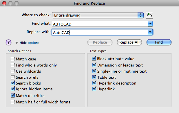

Specifies the text you want to find, replace, or select and controls the scope and results of the search.
The following options are displayed.
Specifies whether to search the entire drawing, the current layout, or the currently-selected object. If an object is already selected, then Selected Objects is the default value. If no object is selected, then Entire Drawing is the default value. You can use the Select Objects button to temporarily close the dialog box and create or modify the selection set.
Specifies the text string you want to find. Enter a text string, including any wild-card characters, or choose one of the six most recently used strings from the list.
For more information on wild-card searches, see Find and Replace Text in the User’s Guide.
Specifies the text string you want to use to replace the found text. Enter a string, or choose one of the most recently used strings from the list.
Closes the dialog box temporarily so that you can select objects in your drawing. Press Enter to return to the dialog box.
When you select objects, Where to Check displays Selected Objects by default.
Replaces found text with the text that you enter in Replace With and moves to the next instance of the found text if one exists.
Finds all instances of the text that you enter in Find What and replaces it with the text in Replace With.
The Where to Check setting controls whether to find and replace text in the entire drawing or text in the currently selected object or objects.
Finds the text that you enter in Find What. The first text object that matches the search criteria is zoomed to. Once you find the first instance of the text, the Find option acts like a Find Next, which you can use to find the next text object.
Defines the type of objects and words to be found.
Includes the case of the text in Find What as part of the search criteria.
Finds only whole words that match the text in Find What. For example, if you select Find Whole Words Only and search for “Front Door,” FIND does not locate the text string “Front Doormat.”
Allows the use of wild-card characters in searches.
Includes text in externally referenced files in search results.
Includes text in blocks in search results.
Ignores hidden items in search results. Hidden items include text on layers that are frozen or turned off, text in block attributes created in invisible mode, and text in visibility states within dynamic blocks.
Matches diacritical marks, or accents, in search results.
Matches half- and full-width characters in search results.
Specifies the type of text objects you want to include in the search. By default, all options are selected.
Includes block attribute text values in search results.
Includes dimension and leader object text in search results.
Includes text objects such as single-line and multiline text in search results.
Includes text found in AutoCAD for Mac table cells in search results.
Includes text found in hyperlink descriptions in search results.
Includes hyperlink URLs in search results.
